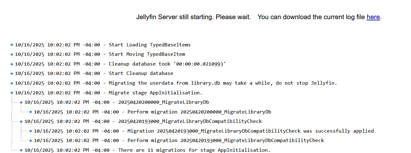

Deduplication and Migrations
The core of the migration involves a transfer of all Library data from the legacy library.db
to the new structures within jellyfin.db
. While this seems simple on the surface, as part of the conversion process we decided to actively try to improve the schema while we were at it, allowing us to simultaneously clean up a lot of the aforementioned spaghetti code. Thus the migration itself creates proper relational cross-references in the database, including foreign keys, for the first time.
The downside however is that inconsistent and logically corrupt library data is prone to cause problems during the migration, and this has been a source of many issues. The migration must not only restructure the data but fix these logical corruptions and clean up any data that "doesn't make sense" anymore, for example Media items with no parent or duplicated People data for multiple sets of media.
This deduplication and cleanup is very time intensive, and the scale of the cleanup depends heavily on how many logically inconsistent entries are present in the existing database. This essentially means that, the older your database is, and the more logically corrupted entries it has, the more the migration needs to work to clean all of it up, prolonging the migration process. This also makes it very hard to estimate how long the migration can take: a database with 300,000 entries but no issues can migrate in a matter of minutes, while one with just 30 series but severe inconsistencies can take multiple hours.
Thus, when it comes to running the migration, we reiterate letting it run during an off-peak period like overnight, and simply letting it run to completion; if it completes quickly, you're golden, and if not, you will avoid delaying users' access.
Startup UI and Log Viewer
One nice little feature that grew out of the migration work and the corresponding long-running initial migration was our new Startup UI and Log Viewer. Before this feature, while Jellyfin was starting up and running through e.g. migrations, the system would appear dead - the UI would not load, and it appeared like very little was happening unless you had your log level set to debug. The Startup UI changes this by providing a simple startup WebUI which is only accessible in your configured local networks, and which will display the current status of the startup process and log messages while the system gets ready, giving you more peace of mind about what's going on. For small instances this might not even be visible, but for slow-to-start large instances this can be invaluable for tracking progress and debugging issues.

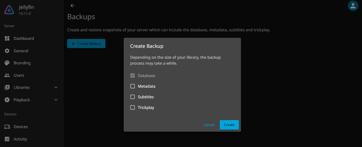

Internal Backup & Restore Support
One of the first big benefits of the new backend is a very eagerly-awaited feature: internal, live Backup and Restore support! You can now take a full snapshot of your metadata database, back it up to external storage, and restore from it in the event of a major fault. You can also take regular backups just in case. This will greatly help both normal day-to-day maintenance, as well as upgrades in the future, always knowing that you have a good copy of the data.
The backup and restore system can only restore systems on which the backup was originally made, so this is not a tool to migrate from other OS's or 3rd party containers.
